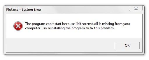

Error when creating "plt" file from "dxf"
7 replies
5 subscribers
24 views
keyur pathak
over 10 years ago
Corrado Galluzzi
over 10 years ago
The message is clear. You miss a.dll file.
I am sure you can find it in the PDMS folder (PDMSEXE)
Copy it from there and paste it in your plot folder

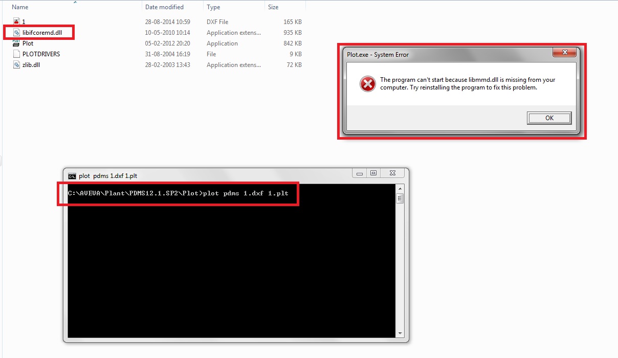

Corrado Galluzzi
over 10 years ago
Tha's another .dll missing !!!!!!!!!!!!!!!!!
keyur pathak
over 10 years ago
Dear Corrado,
The missing .dll file named "libifcoremd.dll" is located in my installed AVEVA folder at two places - "C:\AVEVA\Plant\PDMS12.1.SP2\dars" and "C:\AVEVA\Plant\PDMS12.1.SP2".
So, Should I copy it to "C:\AVEVA\Plant\PDMS12.1.SP2\Plot" folder also?
keyur pathak
over 10 years ago
keyur pathak
over 10 years ago
Oh....my mistake.
Problem resolved.....thank you very much corrado........
