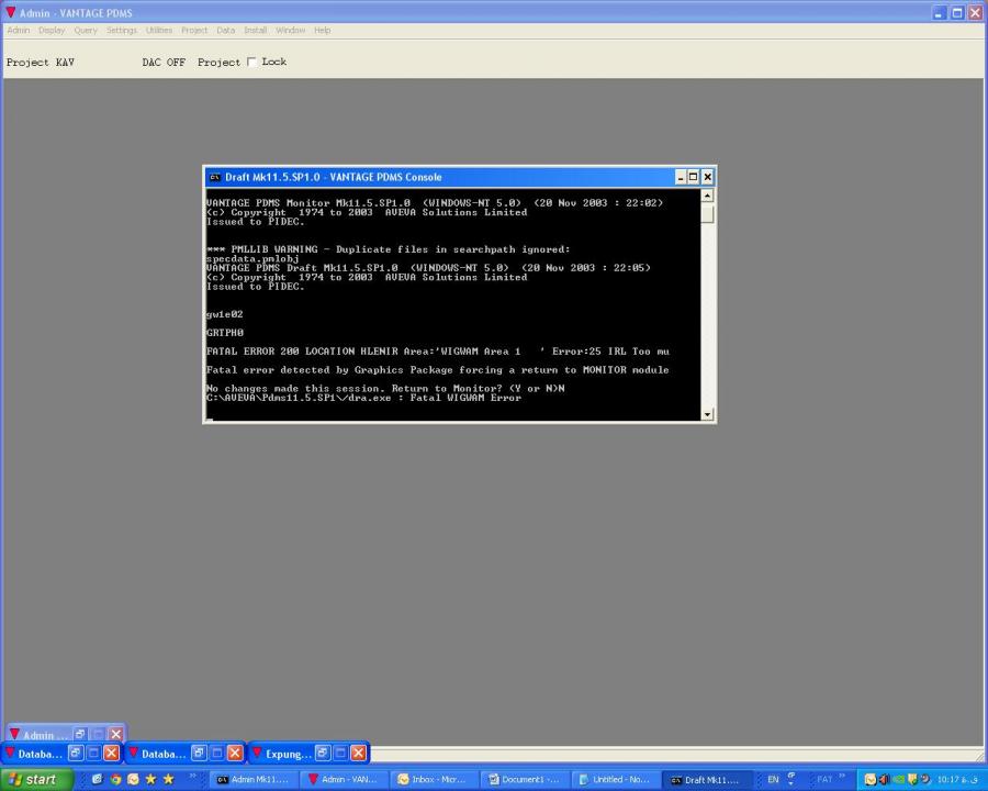

Urgent : Fatal error <<wigwam>>

The sheet contain some illegal component.
The way to solve is without opening the sheet Copy the sheet and paste in the drawing.
Then delete the sheet which has error.And open the copied sheet.It will work fine.

after many times , i found this problem caused by "hatching rules"
