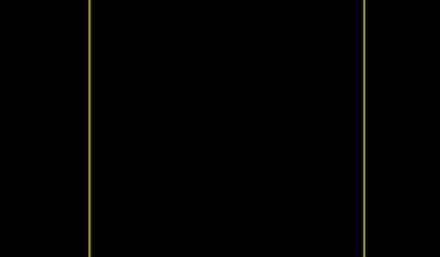

Thanks corado. ..I am talking about cable tray ..ie branch ...problem is in rule set if I am trying to provide single line it is not taking whether we need to set rules like match etc
Thanks Corrado ...The above mentioned i have tried before ...The problem is when i am switching off front face ..no Cable tray appears ,,.....That is i have set all in pipe normal in style level...So what shall I do
It depends on which Cable Tray Catalogue you are using.
If you want to see "centerline elements" you need to define primitives with Centerline Flag ON in Paragon.
