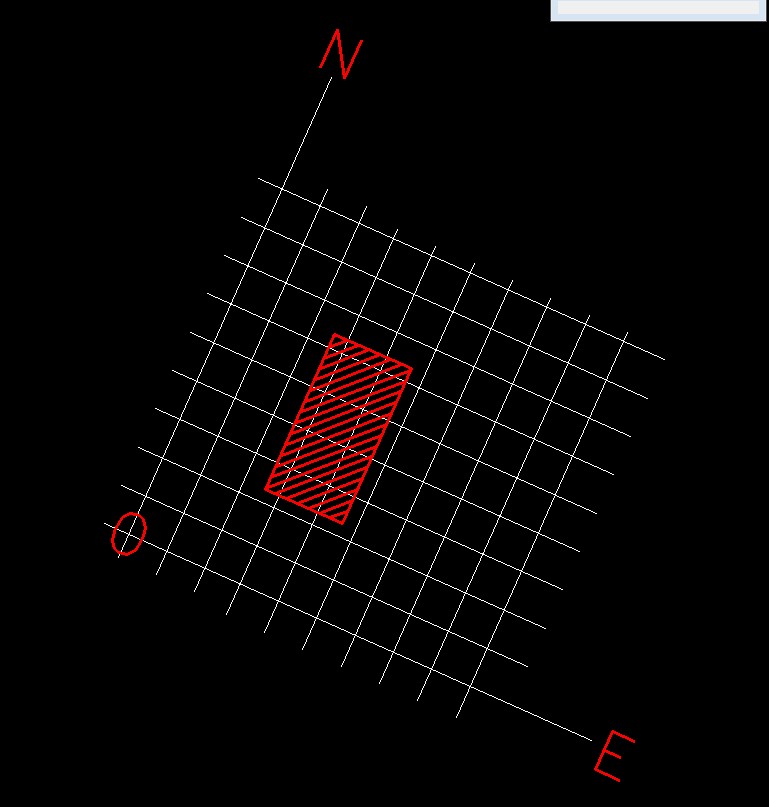

[QUOTE=Nilesh_Solanki;98664]I have got one PDMS project, where modelling of plant needs to be done at an angle from Y axis. (Tilted plant).
To accomplish this task, site with required ORI is created and accordingly modelling is being done.
Now I want to extract view (GAD) of that plant. Please refer attached snap.
How to extract view of shown part in Draft ? What should be the procedure so that view with shown volume in RED color (with the help of coordinate) can be created.
I am not sure about the dimensioning. But I guess 2d views can be generated by the help of clipping planes and specifying custom view angle.
