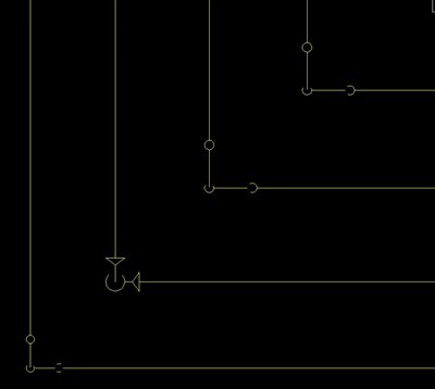

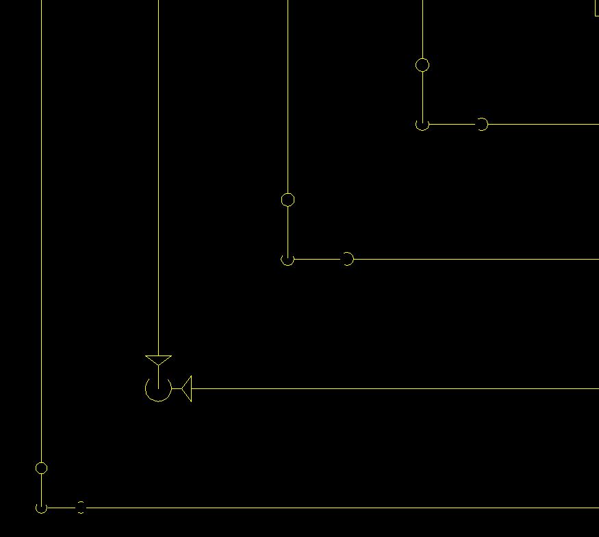

Draft Module Draft Representation problem
  • Replies 7 replies
  • Views 21 views

    Any body help me on this? I am using PDMS 12.1 sp2.37
  • Eric Callis
    Eric Callis over 9 years ago
    Kav,
    Are these SCTNs?
    The views look like different areas of a floor.
  • kalpak vartak
    kalpak vartak over 9 years ago
    Hi,
    I am not sure in both drawing surface areas are different or not but this affect the representation pf pipe?
  • Eric Callis
    1. Please Datal some pipe out of your old project and into your new project (I hope the pipe specs are the same).
    2. Create a view with the pipe you dataled out with that same properties in both the old and new projects.
    3. Compare these views.
    4. If they are different, then your Draft setup (RRST, RRULs, STYLs, etc) are different in the two projects.
