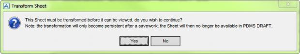

Draft Module E3D Draft --> Transform Sheet
  • Replies 3 replies
  • Subscribers 5 subscribers
  • Views 8 views

    You transform it into E3D Draw format so it no longer can be used in PDMS
  • Cary
    Cary over 9 years ago
    PDMS DRAFT and E3D DRAW are different so it needs to be Transform (Sort like upgrade) but this will not be compatible in PDMS anymore unlike other objects that it can be use by PDMS and E3D simultaneously. Although they have similar hierarchy and attributes the difference must more likely internal.
