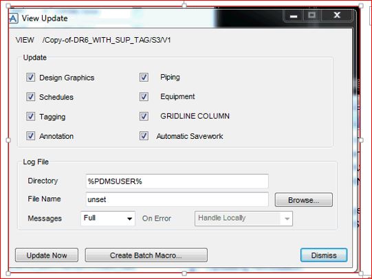

ADP DRAWING EXTRACTION USING dra-genadp-piping FORM GIVING ERROR ASP PER BELOW.

It seems you have not defined your rules properly:
Warning: [UANOTYP3] No elements found matching level 3 rules
Warning: [UANOTYP2] No elements found matching level 2 rules
Warning: [UANOTYP1] No branches annotated, check level 1 rules
Could you please post them here?
