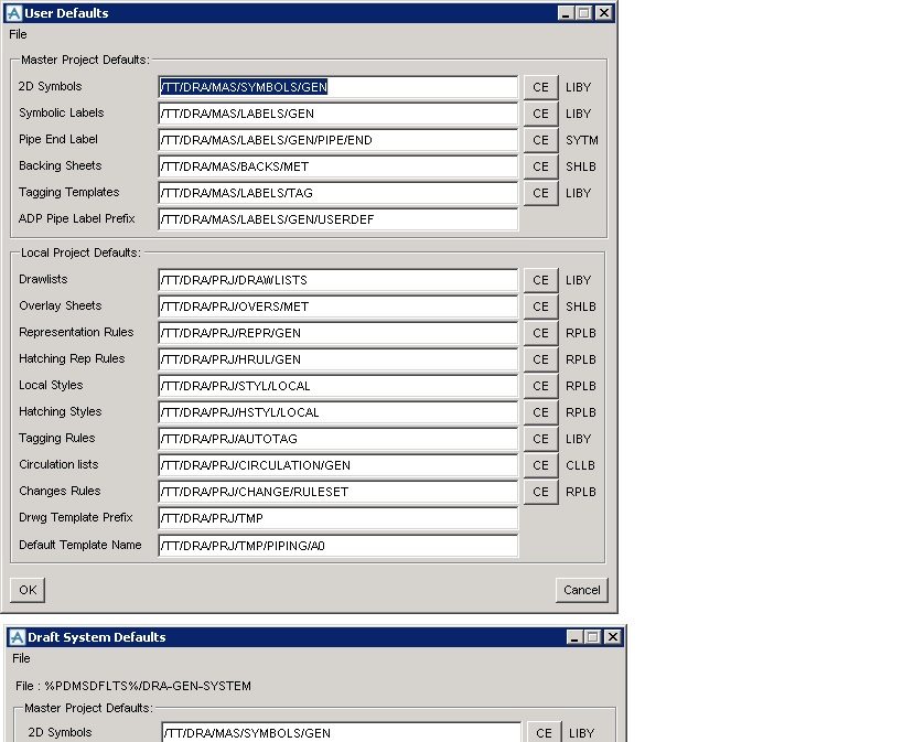

or
1. you can copy the dra-gen-sytem place it to other folder save it as myseting.txt
2. it has similar list as above code but writen differently.. just change the directory as you need it.
3. go back to User Defaults form in PDMS.. and go to file select 'load pre-defined from..'
4. it bring you to select folder form.. so select the file myseting.txt.
5. it will load and DONE!!
