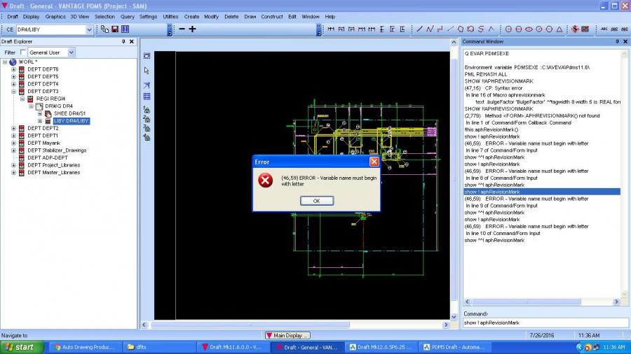

Try to reload the form by command: PML RELOAD FORM !!APHREVISIONMARK
Command to show the form: SHOW !!APHREVISIONMARK
I have notice that you are using PDMS 11.6, I may not sure that all the macro code is compatible with the version you are using. Just try then post the error if you will encounter it.
