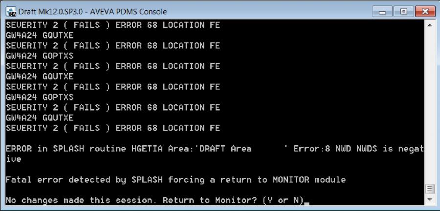

In a new project only administrator can work in draft modul. Normal user can enter draft but is not allowed to work with drawings and I have no idea why. Do you know how to fix it? Thanks a lot for any advices.
while opening the sheet or view it is giving following error
[ATTACH=CONFIG]9835[/ATTACH]
First of all you have NO fixes installed.
You should keep your version as much updated as possible.
Then, do you have a valid and official license?
Finally, as far as I can see, you need to install at least one True Type Font to your project.
