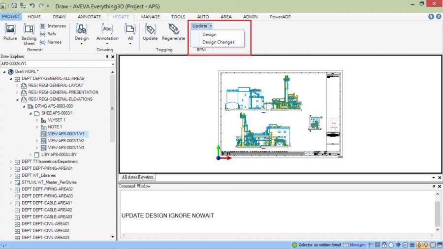

Hello
i could not find the BackGround Process Manager (BPM) in E3D Draw, it's a very useful tool provided in PDMS Draft. anyone here knows how to load it in E3D ?
Much appreciated

Hi,
You can execute the %pdmsexe%\bpm.bat with double click in program manager
or create the short-cut for %pdmsexe%\bpm.bat

Hello,
unfortunately, i am not expert in PML, could you please explain more detail about the steps to transfer BPM to E3D?
Thank you very much
