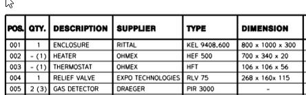

Hello,
could anyone post a screenshot of the Excel and the result in draft?I don't have access to draft for the next couple of weeks, so showing some screenshots could help to convince others to use it before I return :).
