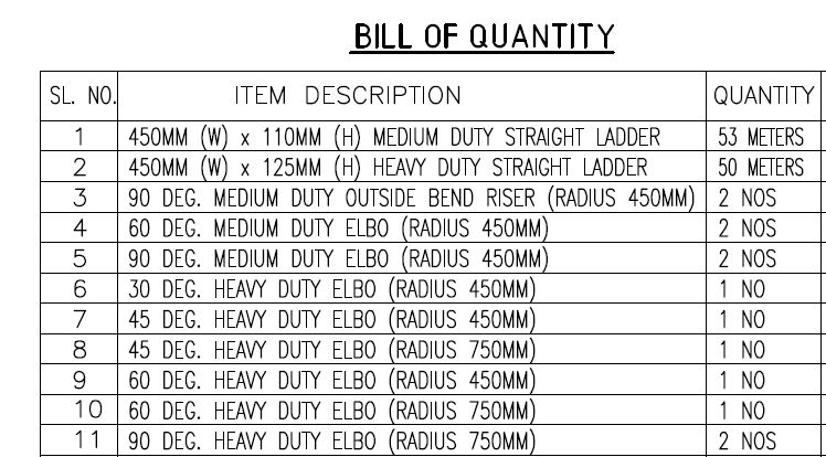

How to print Bill of quantity in cable tray general arrangement drawing in draft

You can do it using Cabling System Material (in Design) + Isometric ADP (in Draft)
They both require a specific license
