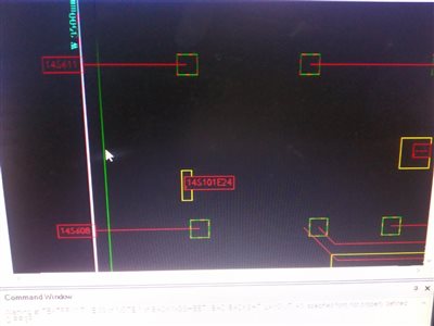

    Crit for Wall /DRAWLIST/WALL/IDLI1 - this idli contains all box used for wall
    Crit for Insert plat /DRAWLIST/WALL/IDLI2 - in thid idli contains all box used as Insert plate.
    note i am looking wall from front side and insert plates are from back side. so insert plates shall be hiddend.
    Insert plate are coming properly (shown in picture) but overlapped by Green hiddelines, which is not expected because the Green style is only for items in IDLI1 list
    So if you closely look in picture you can see insert plates are doubled one Pink and another Green.
