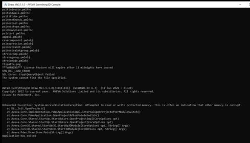

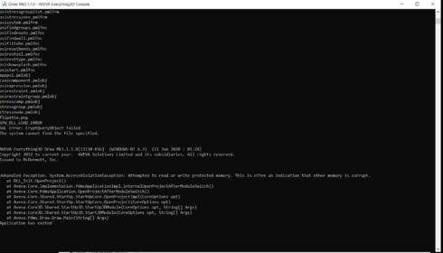

    I have deleted all temp file as well as local file. But still, i am getting same error. Even i re-installed E3D.
  • Below Message is showing in Console window
    -----------------------Message Start-------------------
    *** PMLLIB WARNING - Duplicate files in searchpath ignored:

    SPW_DLL_LOAD_ERROR
    SGL Error: CryptQueryObject failed
    The system cannot find the file specified.
    AVEVA Everything3D Draw Mk3.1.1.0[Z3110-036]  (WINDOWS-NT 6.3)  (11 Jun 2020 : 01:28)
    Copyright 2012 to current year.  AVEVA Solutions Limited and its subsidiaries. All rights reserved.
    Issued to McDermott, Inc.
    Unhandled Exception: System.AccessViolationException: Attempted to read or write protected memory. This is often an indication that other memory is corrupt.
      at DLL_Init.OpenProject()
      at Aveva.Core.Implementation.PdmsApplicationImpl.internalOpenProjectAfterModuleSwitch()
      at Aveva.Core.PdmsApplication.OpenProjectAfterModuleSwitch()
      at Aveva.Core.Shared.StartUp.StartUpCore.OpenProjectImpl(CoreOptions opt)
      at Aveva.Core.Shared.StartUp.StartUpCore.OpenProject(CoreOptions opt)
      at Aveva.Core3D.Shared.StartUp3D.StartUp3DModule(CoreOptions opt, String[] Args)
      at Aveva.Core3D.Shared.StartUp3D.Start3DModule(CoreOptions opt, String[] Args)
      at Aveva.Pdms.Draw.Draw.Main(String[] Args)
    Application has exited
    -----------------------Message End-------------------
