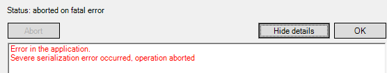

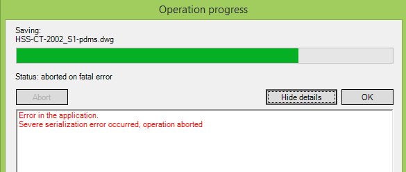

Error in the application - is being shown wile extracting drawing from Draft in dwg format. What could be the reason ? Please enlighten me.

For me this error shows for every drawing.

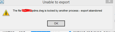

Did you try to restart your computer ? Maybe old process is still running and after installing Fix33, you had some conflict. Do you have some logs to show us about your error ?
This issue has been resolved by adding below syntax in Full_DXF.ac file ( OutputFIileName was 'OFF')
switch OutputFileName '%PDMSUSER%/output.dxf'
