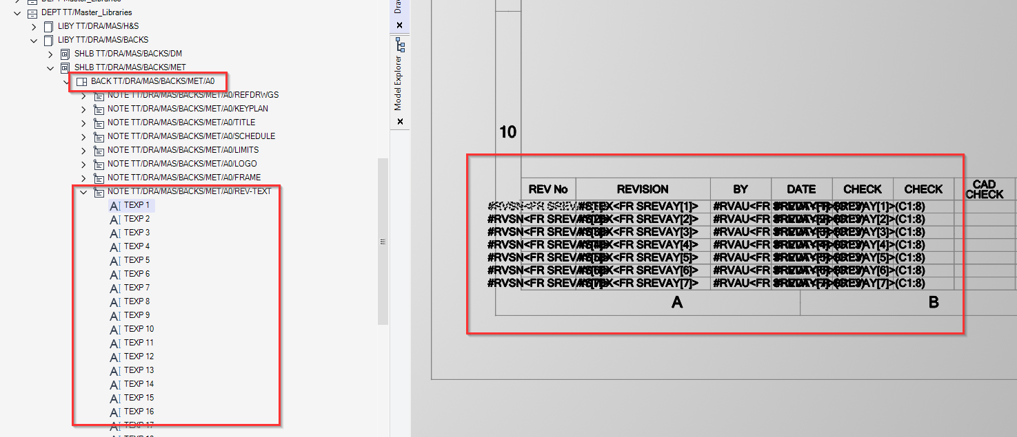

    You can check Aveva supplied backing sheets in the APS Project ( i.e. /TT/DRA/MAS/BACKS/MET/A0 )
