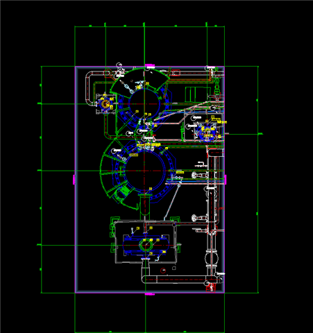

I've added the refgrd in the drawlist, configured the vstyl, rrsf but the grids are not appearing in the drawings as below,
If any ideas kindly advise.

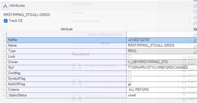

Double check representation rule and style for grids.
In particular NoHLRFlag attribute of RRUL
On the On-Line Help you can read:
Thanks Corrado. I tried that already as below. i'm i missing anything else?
Thanks
Alfred
