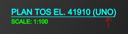

Is it possible in AVEVA Draw to edit a symbol dynamically? I've created a view title symbol, the view name length will vary. Is it possible to adjust the line length accordingly?

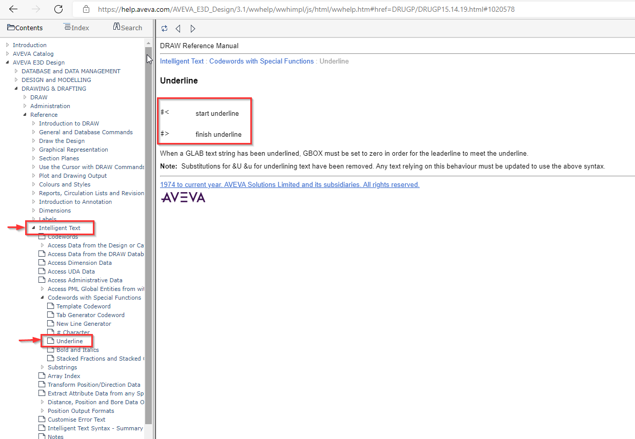

Thanks Corrado, much appreciated! I will look closer at the help file before posting... my bad... Thanks again!
