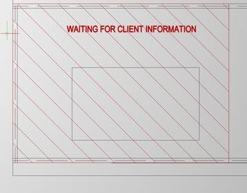

Text blanking on hatching

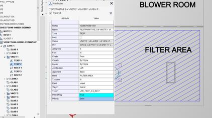

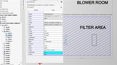

    it seems that it is TEXTP element type in Draw module.
    [TABLE]
    [TR]
    [TD]Primitive blanking flag[/TD]
    [/TR]
    [/TABLE]
    shoul de set to true
    [TABLE]
    [TR]
    [TD]PrBlnkFlag[/TD]
    [TD]True[/TD]
    [TD][/TD]
    [/TR]
    [/TABLE]

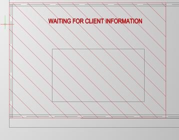

    Annotate - tool - enable blanking
  • Travis Fincaryk
    Travis Fincaryk over 5 years ago
    I don't think there is a way to blank out hatching. You'll have to update the perimeter of the hatch.
    Blanking only works with annotation over Model geometry.
