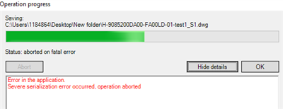

Unable to export drawing to DWG file.
Nalliboyena Yudhister varma
Nalliboyena Yudhister varma over 5 years ago
    Corrado Galluzzi over 5 years ago
    Make sure your SHEE element is up to date

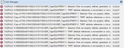

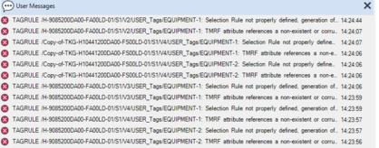

    It seems you have Tag Rules problems.
    Ask your Administrator to fix them.
    For now, try updating 3D graphic only (DESIGN) and not annotations.

    I am currently using 2.1.0.17[Z21017-15] version
    Ok. Make sure you do not have two or more coincident DPPTs or that the projection line length (OFFSET attribute)  of the first DPPT is not equal to zero
    Anyway that was a known issue that should have been fixed now with the latest Fixes (current one is no. 22)
  • Nalliboyena Yudhister varma
    It is observed that after deleting the dimensions i am able to export it without any issue. But how come dimensions creating problem.

    Could you tell me what is actually tag rule problem ?
    This should be your administrator job.....
    Anyway...it says that your template is missing (TMRF : Template Reference)
