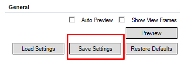

Save the config export DWG

If I am not wrong users need to belong to the DRAWADMIN team...

Thank for your answer.
With the DRAWADMIN team, it doesn't work either. In the APS project, this "Save settings" option is not also available.

After some research
This button saves the parameters of the export interface. Draw under the following file:
%LOCALAPPDATA%\Aveva\AVEVA Everything3D\2.1\DrawSettings\Config\config.xml.
The "Load settings" option can take only the pmldat file, so how it's possible to apply the config for all user of project
Regards
