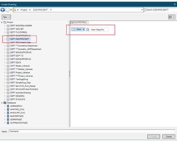

How to create new DEPT in the desired database?
I use draw to create new DEPT, it has only option to create DEPT for first database in MDB.
If i select an existing DEPT, it has only option to create REGI under this DEPT.
1) Navigate to an existing DEPT in the required database and create a new one using the GUI
2) Change Draw Explorer Setting so that you can see databases. Navigate to the required one and create the DEPT using the GUI
