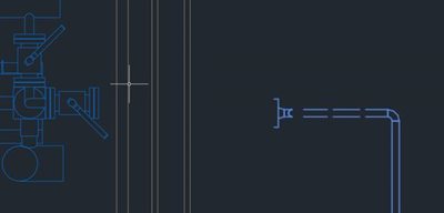

Hi.
Remove the unwanted Pipes from Drawlist.
Or generate a section between your "wanted" Pipe and your "unwanted" pipe.
So you will see only your "wanted" pipes.
[QUOTE=joge;119157]Hi.
Didn't think the obvious, managing the drawlist I can get the whole blocks in dwg to designers.
[QUOTE=Tejas;119161]maybe you can try changing to model wireline.
also you can change obscure line style in representation library

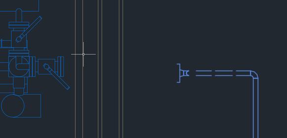

Does wireline model change to dwg export? I have to try, the picture attached is from AutoCAD.
I was wondering if the dwg export could hold the information in the blocks. So that I could, for example regen the block in the autocad, so the pipe lines would reconnect.
I think that how E3D makes the dwg, it forgets everything behind most closest object.
