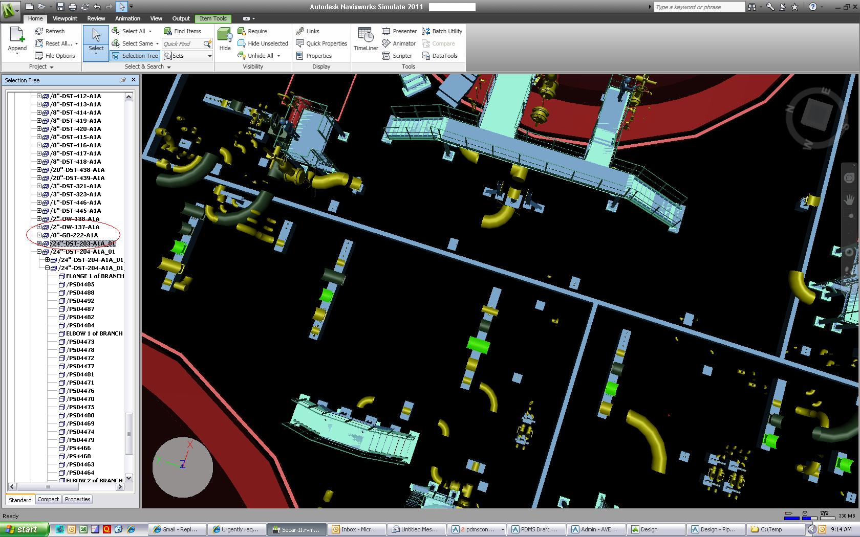

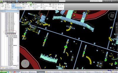

[FONT=Times New Roman]Recently we updated PDMS sp.6 to PDMS 12.1.SP2.and also updated the working project. For the purpose of creating review file the all pipelines are added in two Group worlds. But when we created the review file the pipes are not showing from the groups. Only MDS supports and pipe names are showing.... But same lines we can able to add by individual Zones or individual line number wise. Please give me a solution for this problem?....Advance thanks for your kindness.......[/FONT]

A quick look at that picture makes me think that it's just the TUBE which is missing - have you checked the representation settings that were used when exporting?
