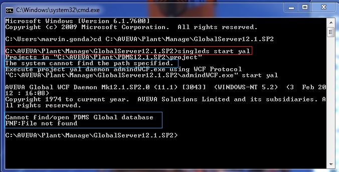

Global Module Error Starting Daemon
  • Replies 3 replies
  • Views 38 views
Marvin O. Gonda
Marvin O. Gonda over 10 years ago
  • Marvin O. Gonda
  • PH
    PH over 10 years ago
    Hello,
    for what, you need the evarssam?
    Write pause after evars call. Then you can see which path is wrong.
    Write Echo on on the top of the bat to get more informations. Also in the evarsyal
  • Marvin O. Gonda
    Hi peter,
    I already solved this issue, I just modify some line and update some DB.
    But as I start the daemon, program not responding always appear.
    Any thoughts?
