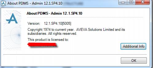

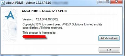

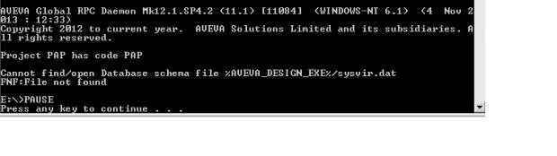

    Are you sure that PAP is a 12.1.SP4 Project?
    xxxvir.dat files  are templates virgin databases  from version 11.6....if I am not wrong....
  • ROBERTO CINQUEGRANELLE
    ROBERTO CINQUEGRANELLE over 10 years ago
    That's PDMS version.
    I am talking about the project.
    sorry...I have not understood your question...
    the PAP project was created in 12.1 SP 4.10.
    the Global release is 12.1 SP4.

    solved!
    previous installation of PDMS Plant  incorrect.
