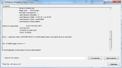

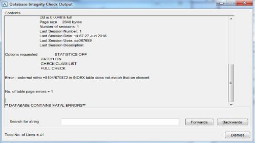

    Stop daemon at satellite location and if possible at hub location and Delete transaction DB.
    Once Daemon starts new transaction DB Created which we resolve more issues.

    thanks Deva, let me try. I do not have a administration rights at satellite side. I need to request hub administrator do that.
  • Udaya
    Udaya over 6 years ago
    system was not allowing to delete transaction DB, we replaced with the old one and deleted it.
    Is right what we did ?

    [QUOTE=udayr;108582]system was not allowing to delete transaction DB, we replaced with the old one and deleted it.
    You should stop the Daemon first at your location to create a fresh transaction Database by locking the project.
