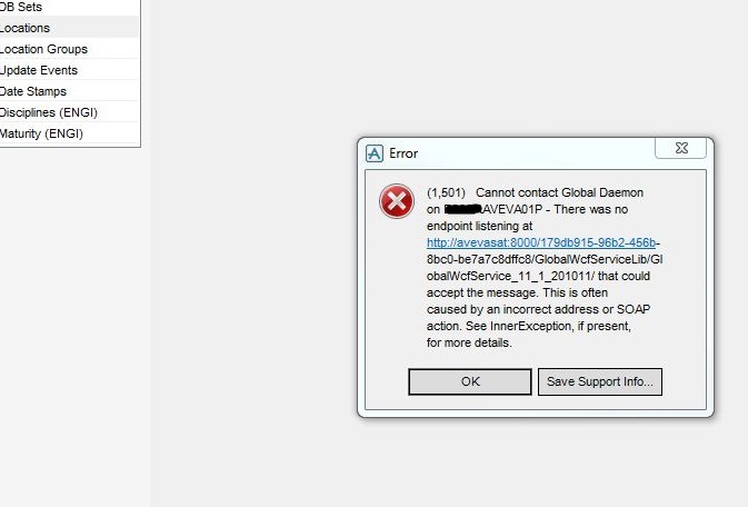

  • [QUOTE=keattavan2008;112014]our satelite location it shows connection is uninitialised.
    but hub and ctx r okay pls check the snap
    while ping it gives this error
    PING LTS
    (1,501)   Cannot contact Global Daemon on AVEVASAT - There was no endpoint listening at http://avevasat:8000/179db915-96b2-456b-8bc0-be7a7c8dffc8/GlobalWcfServiceLib/GlobalWcfService_11_1_201011/ that could accept the message. This is often caused by an incorrect address or SOAP action. See InnerException, if present, for more details.
    In line 2 of Command/Form Input
    PING LTS
    Initialisation failed. Could not contact daemon on host details.
    In line 96 of PML function glbinitialise
       !!messageFile.error(141, 713, !!error.text.part(-1))
    Called from line 1 of Command/Form Callback Command
    !!glbInitialise()
    Im also getting error,Would like to know the solution
    PING LTS
    PING LTS
    !!glbInitialise()

  • I tried it but not initialised
    I can able to ping the LOC/HUB
    Possibly to provide the checklists
