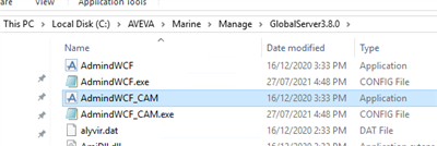

• From the pictures you have posted it seems you have NOT changed the starting command to meet the new format.
    You need to add the project evars path/file (second argument) just after the project code (first argument).
    See my example here below:
    "D:\AVEVA\E3D3.1\GlobalServer3.8\AdmindWCF" START GTP "D:\AVEVA\E3D3.1\Projects\GTP\evarsGTP.bat"

  • hi atish we are using rpc with 3.8
    need to use admind.exe or admindwcf with changed rpc protocol for this requirement?
    hi sakura it worked for you.
    Kindly help me.
