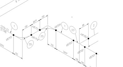

Fitting Dimension In Iso

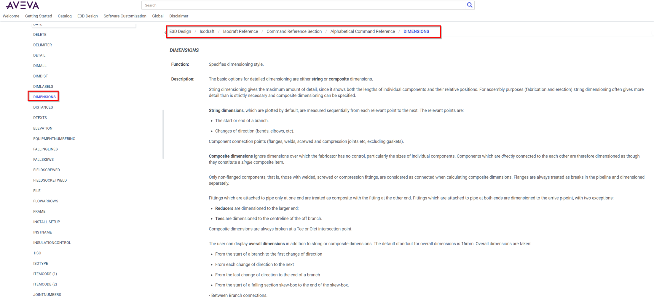

    Use String dimensioning. See DIMENSIONS in the Isodraft reference manual. Page 2-53
    Corrado Galluzzi over 1 year ago in reply to Praveen Paladugu +1
    You can read here: AVEVA Help

    Pitch thanks for your replay, but I've read this sequence of manual before I wrote my question. I've checked some combinations of options but I didn't achieve desired effect. I don't know what I've done wrong.
    Below you can find some part of my file which is used in isodraft:
    Dimensions ON
    Dimensions Composite OFF
    Dimensions Overall OFF
    it doesn't work

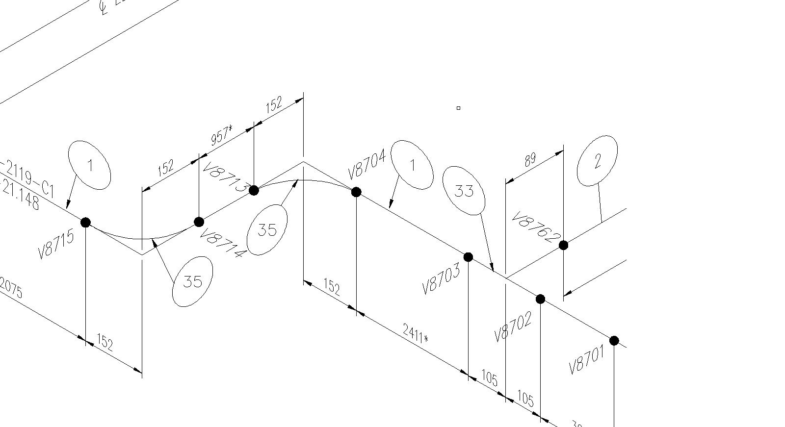

    Hello, I had a same problem with dimensioning in ISODRAFT. The project requirament is to have fitting dimension, strings dimension alongside for supports and overall dimesions. I had play combinations and read ref. manual also but I didn't come with solution. I need that string dimensioning fitting dimensions and in every combination it is not giving me. I have other two!
    Please, help us out here!

    You can read here:

    I WNAT ELBOW DIMENSIONS, WHAT IS THE COMMAND FOR GETTING ELBO DAIMENSIONS, INLET TO CENTER AND CENTER TO OUTLET
    May I ask you why?
    Try changing elbow's SHOP attribute from TRUE to FALSE.
    But this will cause creating further spools and moving the elbows from fabrication material to erection material.
