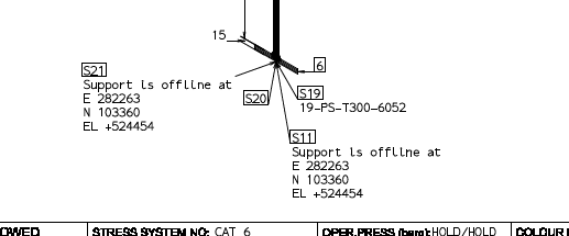

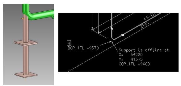

    Anyone here know what's wrong when 'Support is Offline at' is popping out on support tags in isometric drawings?

    Could you please specify version/fix?
    Could you please post some image (both isodraft and 3d model)?

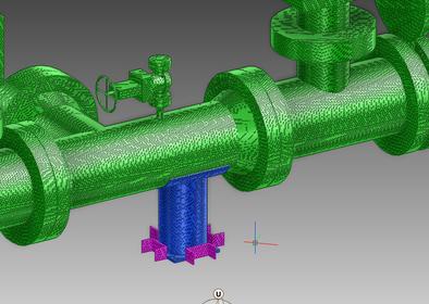

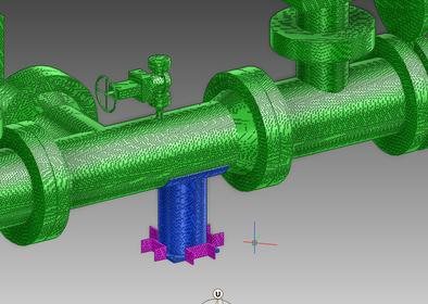

  • Atish naresh parkar
    Atish naresh parkar over 4 years ago
    navigate to the guide and set the LOFF false, this will solve the issue for the support offline at message in isometric but will give health check error while modifying the support.
    to fix the health check issue copy the name of the plate and set it as a compref of guide.

    can i change the description of the "Support is offline at" to something else
  • Arif Kazaro
    Arif Kazaro over 1 year ago in reply to Arif Kazaro
    it happen to all item at base of trunnion
