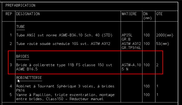

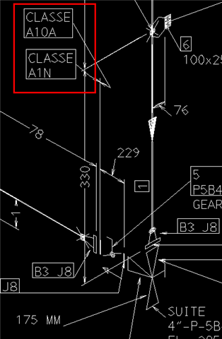

I have a spec change on the same branch. The spec changes between two flanges. In the isometric, I can see the spec change flag but in the material list, it shows the two flanges with the same material ref. What am I doing wrong here?

One flange is carbon steel and the other is stainless steel. But in the material list, they both show carbon steel
This could depend on the ITEMCODE setting, but unfortunately itemcodes are not displayed in your material list.

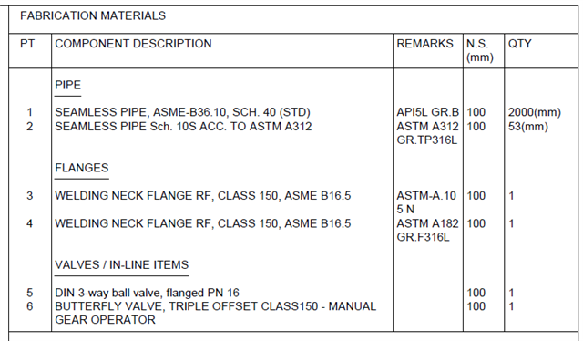

Try switching on the following flag in your option file:
Material List-->Multiple Descriptions/Itemcode
This fixed it, thanks!
