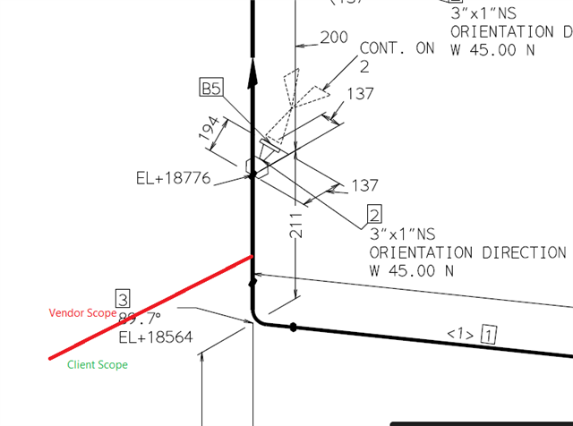

Is there any way to change the Scope Change as marked here
You can use PTSPEC attribute of branch.
But you need to create two different branches connected at vendor/client limit
