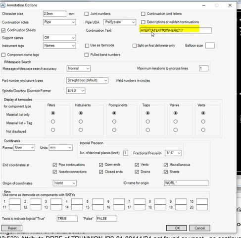

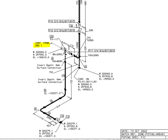

hi all,
i am requiring the line number details in isometric please refer snap , i tried it doing with atext but no success refer snap
i tried doing this with updating the continuation text please refer snap
please guide

Maybe using a simple attribute "NAME" in that field?
Try delete that code "ATEXT#(...)" and write only NAME
