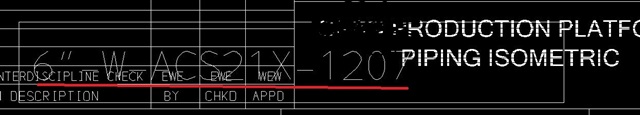

Hello /*,
How do you switch off or position this default ISODRAFT option (please see below).
Thanks for your TIME!
Hello /*,
You must re-position the (pipe) NAME somewhere else and that one will be switched off.
Thanks Corrado..funny how its works but who cares?
You just set the Character Height to 0mm to Switch Off all those pre-loaded Isodraft Text attributes
TextPosition NAME X 0mm Y 0mm CharHeight 0mm
