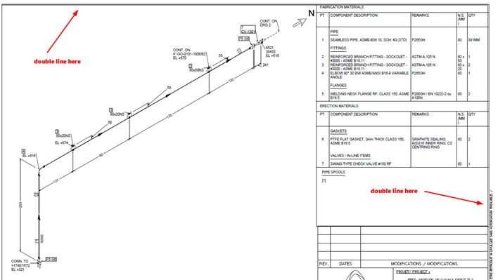

Why am I getting a double line on the top and right side of the isometric drawing?
I tried changing the MARGIN and RESERVE options but it hasn't changed much. Thanks for your help!
Hi, could it be, when you export the iso-template to a plt-file in draw and select the plotted area by option [Window]
you have the option [Show View Frames] checked on?
