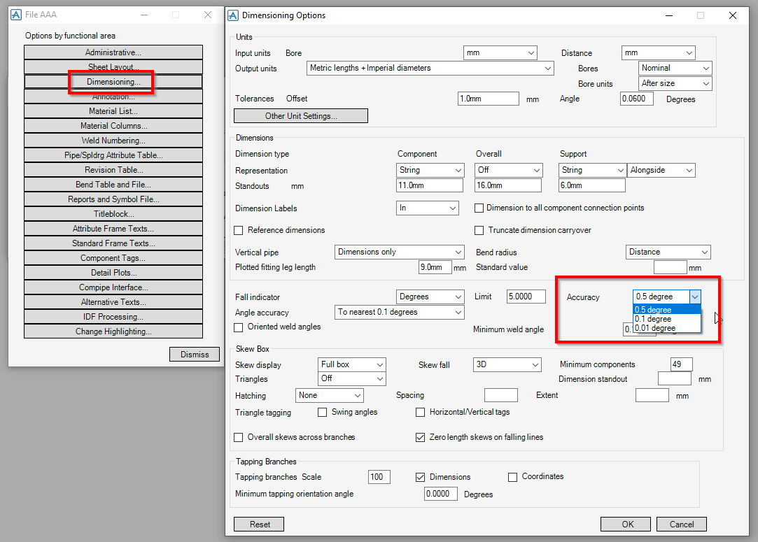

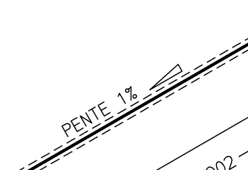

Value of slope rounding off to 1 significant figure (1%) instead of 1dp (0.5%)
In model i used a slope of 0.5% ( 0.29 in degrees).
However when i am extracting isometrics, the system is rounding off the figure to 1%. Should I be more precise in the value of degree I am using in the model or what should be done?
Thanks in advance.
