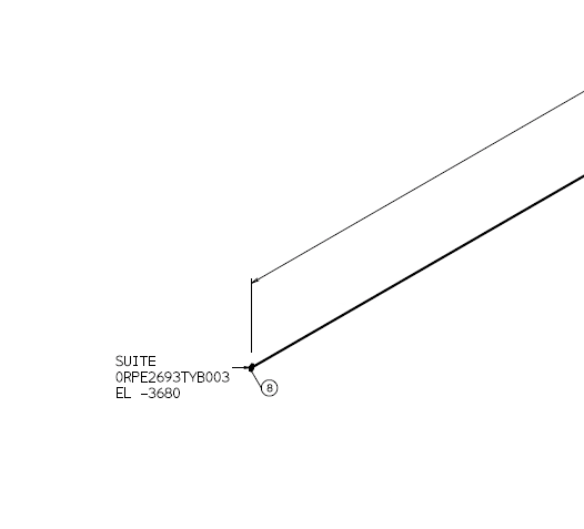

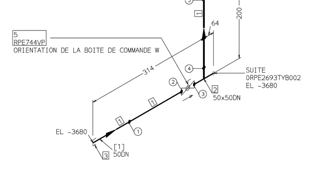

Is it possible to maintain continuity of weld numbers when extracting isos from several branches of a pipe?
For ex.
on branch 2 I have 8 welds and on branch 3 it starts the numbering again instead of continuing from 9.
