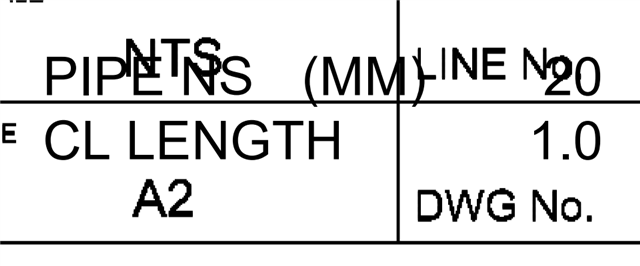

Hello all,
how can i modify the pipe length cl appears? I cannot move it at all
Thank you all in advance

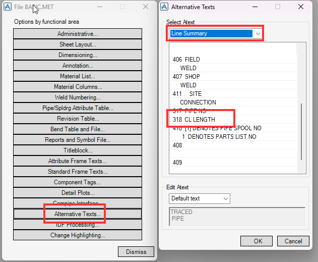

Efi,
you can change the text here:
But as far as I know, you cannot modify the position unless you change the bottom margin
