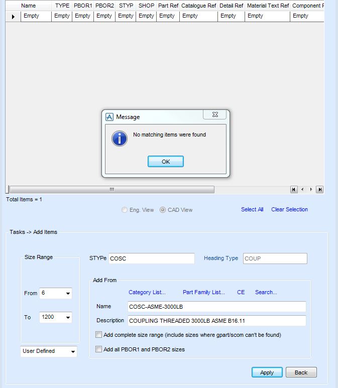

Paragon Module No matching items were found
  • Replies 6 replies
  • Subscribers 6 subscribers
  • Views 47 views

    Corrado Galluzzi over 9 years ago
    Try switching "Add All PBOR1 and PBOR2" flag ON

    Hi,
    Thanks Corrado, it works, but I don't know what seems to be the issue in my category, like I said in the previous message with the Aveva category works without setting the flag ON for "Add All PBOR1 and PBOR2".
    Regards,
    Laurentiu
  • Perdana
    Perdana over 5 years ago
    this goes the same with my problem, plus, when i try to add PBOR1 and 2, it was added to the spec., but the problem is, it still not shown up in the model.
    any clues?
  • laurentiu pojogu
    laurentiu pojogu over 5 years ago
    Try to add 2 different parameters for each bore p1 and p2,  p1bore - para1, p2bore - para2.
  • Perdana
    yeah, already solved yesterday. it appears that coupling SHOULD have 2 type of size and connection.
    so, we have to fill the parameter both for the P1 bore and connection, and also P2 bore and connections in the parameter table.
