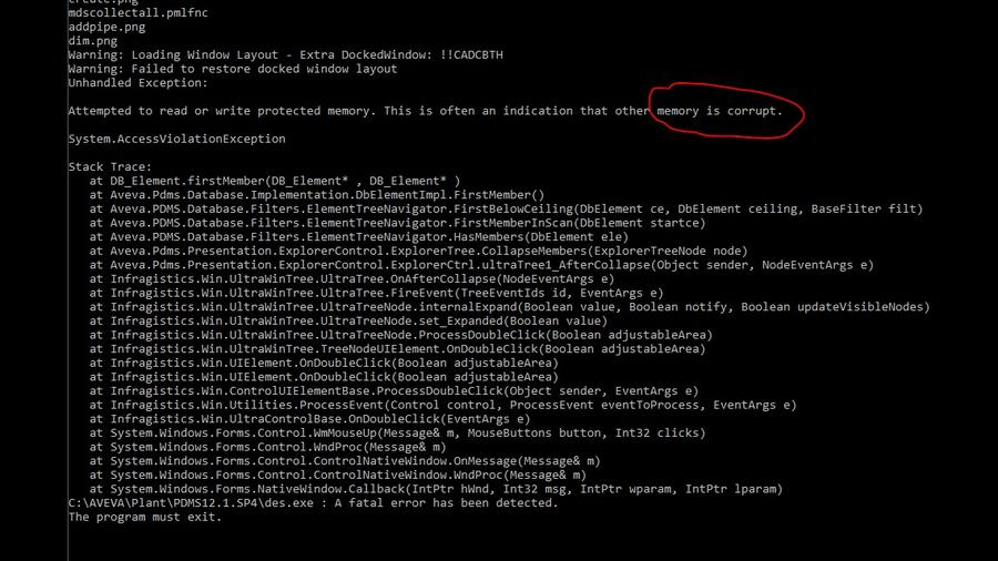

Check if you have correct version with service packs loaded on the machine.
Let know if things were working before an now started breaking if so what was the last change done.
Please also check dice for the database allocated primary to you and validate same.
Also check if you can add elements (SPCO) under your spec SELE (last member in some size range) by command new SPCO.
Hey @kunalcjadhav, I can create the spec manually via command line, guess the form's corrupted. As far as the service pack and versions are concerned. I have to match the ones being used by HUB
and since they don't use the default forms for editing specs, They wouldn't have come across this at all. This was helpful exercise thanks.
DICE and allocations are all correct.
@deva, I guess new databases from HUB won't really help in this case, it's most likely an AVEVA form issue. I will take this up with tech support.
