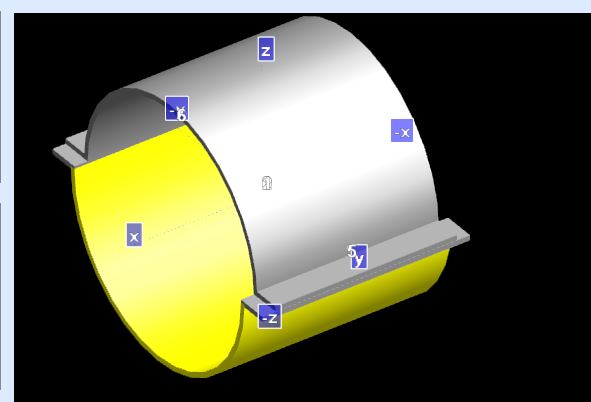

    [QUOTE=kiranbachhav123;109250]Hi,
    can anybody having the answer
    i have created clamp in paragon but while selecting in design i want to change that with respect of insulation.
    currently it is fixed. see the attached snap.
    thanks
    U can add parameters as variable not fixed , so u can change in design modules, as per your requirement..

    Include (IPARAM) while setting the dimensions for the Clamp.
    Insulation parameters (IPARAM) allow the main Component to take dimensions from the Insulation Component. When the main Component uses IPARAM 3, for example, it picks up the value of the PARAM 3 of the corresponding Insulation Component.
