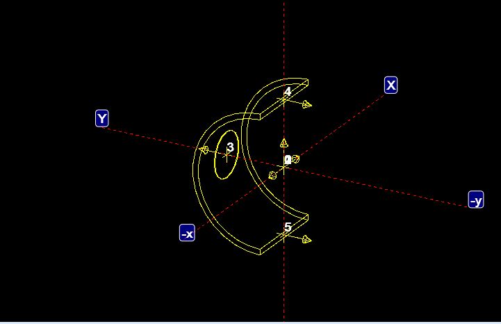

Branch table
Gopinath
Gopinath over 6 years ago
    Set on Tees, i guess
    Yes.
    With two different SKEY attributes.
    TESO and TERF (ReinForced)
    Those codes could be customized by users.
    https://www.avevaworldforum.com/showthread.php?10672-how-to-edit-the-short-code-in-branch-and-reducer-table-in-pdms-12-0-sp-4
    I normally use ST and PAD for Set-On and Reinforced Set-on tees.
