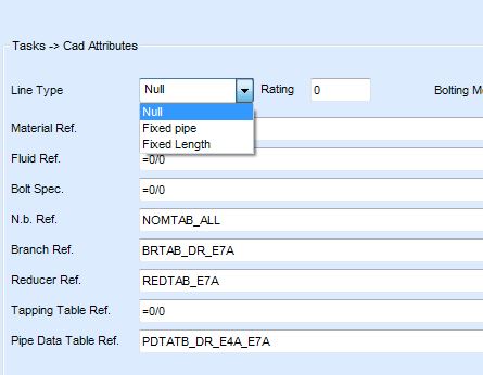

  • mEhul_patel
    mEhul_patel over 6 years ago

  • mEhul_patel
    mEhul_patel over 5 years ago
    [QUOTE=mEhul_patel;111883][ATTACH=CONFIG]11251[/ATTACH]
    hello pratik,
    u can try, i don't think so, its working or not...
    hi, corrado,
    what is the purpose of fixed pipe and fixed length??
    Thanks,
