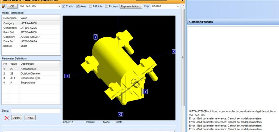

Paragon Module Catalogue error

Catalogue error

    Corrado Galluzzi over 5 years ago
    I would check Data Set (DTSE) and DATA elements...

    Ciao Corrado, Could you please explain in details so that I will go through it.
    The error message is related to "Model Parameters".
    So, to me, it means that the issue is probably about "Design Parameters"
    A Dataset is made of DATA elements.
    I would check them one by one and see if the "design parameter" ones are correctly defined.
    Then I would check each p-point and each 3D primitive that contains design parameters in expression/syntax.
