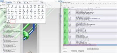

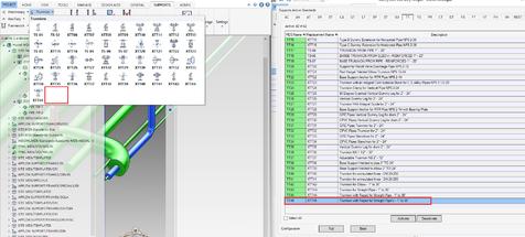

Hi Paragnewe,
I have added in below PML files. [COLOR=#333333]But still its not visible in design [/COLOR]Is there any PML am missing to update.
[COLOR=#333333]2) TT45 added in
supportconfiguration.xml
file.[/COLOR]
[COLOR=#333333]3) TT45 added in
MDSSTANDARDS.pmlobj
Object file[/COLOR]
[COLOR=#333333]4) TT45 added in
MDSSUPPORTEDITORCTRLCONFIGTT.pmlobj
object file[/COLOR]
DUNG VO
over 4 years ago
Hi Kumarraj,
Open file named "AVEVA.Design.supports.uic" in Notepad or Notepad++, the search the key word "TT44" then it will jump to row around 1519. Insert the rows below underneath of TT44
I hope it will solve your issue.
