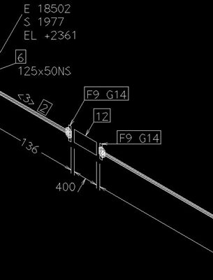

Skey Problem

    What TYPE you used for this?
    Type should be FILT
  • Venkata Rao Peta
    Venkata Rao Peta over 4 years ago
    GTYPE Should be FILT in Catref
    SKEY is Right
  • Baran Tintaş
    Baran Tintaş over 4 years ago
    Thank you guys. I have changed the gtype as you suggested and also in specification I moved the y-strainers from PCOM heading to FILT heading. After that my problem was fixed.
