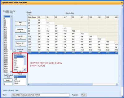

how to edit the short code in branch and reducer table in pdms 12.0 sp 4

Corrado Galluzzi
over 13 years ago
C:\AVEVA\Plant\PDMS12.0.SP6\PDMSUI\dflts\cat-pipetablecodes.pmldat
Pedro Valadares
over 12 years ago
Hello!
C:\AVEVA\Plant\Data12.1.SP2\pdmsui\DFLTS\[COLOR=#333333]cat-pipetablecodes.pmldat[/COLOR] in PDMS 12.1.SP2.
Amrut Suthar
over 6 years ago
Where to find this file in e3d
Cary
over 6 years ago
try
C:\Users\Public\Documents\AVEVA\Everything3D\Data2.10\DFLTS\cat-pipetablecodes.pmldat
Amrut Suthar
over 6 years ago
[QUOTE=cutesmile;111924]try
Thanks cutesmile for your reply.
I could found at this location and worked.
C:\cae_prog\AVEVA\v2.x\e3d\data\dflts\cat-pipetablecodes.pmldat
