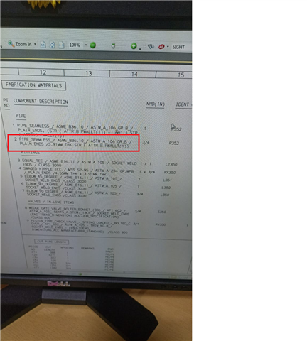

can we use this code in xtext???
XTEXT of what? What is your aim? Could you please explain it better?
sorry , mtxxtext of SMTE , in my case ,the thickness is required under SMTE, all this code is mentioned in RTEX of sdte
Yes! Why not? Just try and let us know...
I tried it, but its not showing desired answer , also the document shows that the syntax can be used in RTEX only!!
It sounds very strange to me.....

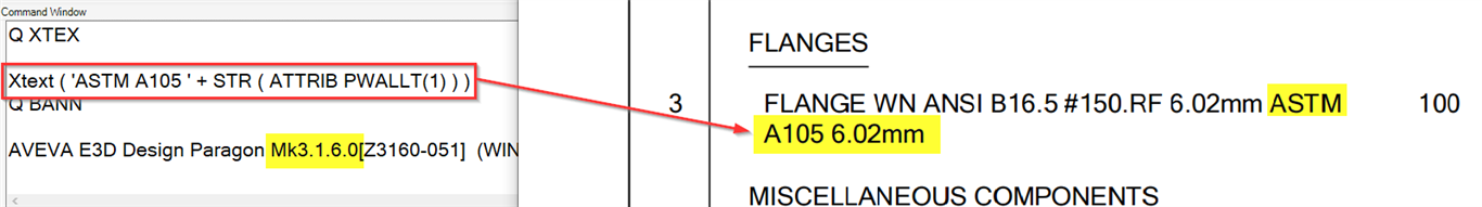

Could you please navigate to the SMTE and on the Command Window type Q XTEX
Post the outcome here please
